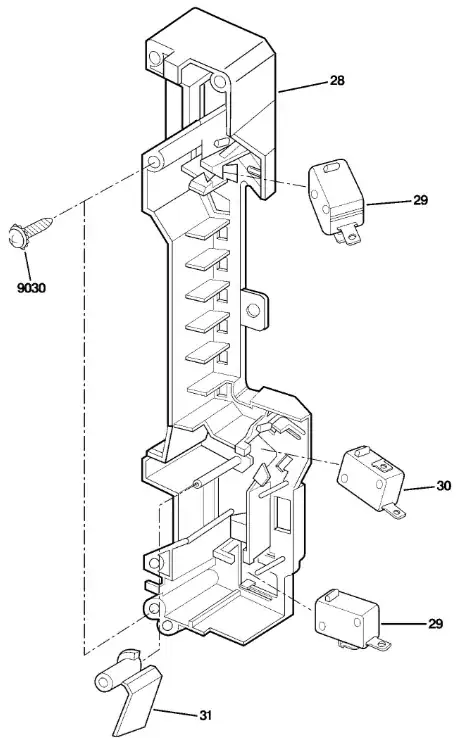

This particular model has three microswitches to detect the door being fully closed. enter image description here
If any one of them are loose or defective, it would cause the symptoms you experience. Each switch is pricey at $30 from GE or $23 from Amazon but there are many low priced sources (see comments below), so I would open up the appliance and have a look to see if a wire has come loose, or a switch is no longer seated properly. With it open, you should also be able to trigger the switch and see if it sounds like it is working correctly. With this type of switch, listening to it can successfully diagnose them 90% of the time.
If all the switches seems mechanically okay, then bust out a DMM and use the ohmmeter to see which one is not remaining closed when toggled.

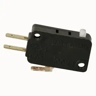

As for testing the switches, just check for continuity - the NO contact should be not connected until the switch is pressed, the NC contact should be connected until the switch is pressed, and both should change to the other condition when the switch is pressed. Pay attention to what wires are connected and where the switches are - it's typical for a contact to be cut off if not used, and which switch goes where (and which wires connect to it, where) are important for the whole business working correctly.
I haven't looked up your specific model but every modern microwave I've taken apart has used a micro switch, they're so commonly used that people refer to them as microwave switches now.
They come in a few different configurations and sizes but only cost a few bucks, you can find them anywhere from RadioShack, Sparkfun, Mouser, Digikey, etc. I'd take a look inside the microwave before ordering but should be a fairly easy DIY if the switch is gone. If the place where the switch mounts is broken or the plastic pushing it is broken you may need to buy an manufacturer part at that point.

Do test your switches with meter.
Besides mechanical malfunctions like a misaligned door or switch, the contacts in these switches can be subject to internal arcing and burning which can leave deposits that interfere with good conductivity through the contacts. This can make a set of "closed" contacts appear "open". You may notice your microwave light flickering after closing the door, instead of going out as expected, along with flaky operation, e.g. complaints from the control panel about the door being open when it is physically shut. A weak spring (internal to the switch) can be the cause of the arcing (contacts open too slowly instead of snapping open, which allows the arc.) So, I realize the OP has already found his/her answer, but I had a very similar issue today and found a set of burnt contacts inside the switch, after testing the switch with my meter. I filed the contacts flat and clean, and reassembled the micro-switch, and retested. Note that I don't consider this a permanent fix (because the spring was probably weak, contacts are marginal, and problem may recur over time) and I have ordered a replacement switch. This answer won't help the OP, but may be helpful to someone else. I don't recommend fiddling with the switches internally as I did, but replacing door switches on a microwave oven can be done safely by a reasonably skilled person who is aware of the potential electrical hazards involved. Replace parts with absolutely equivalent parts. Above all, work safely.

The upper switch, as shown above, may be ruined by high voltage if the oven is opened while in operation. Always wait for the oven to stop on its own or turn it off manually before opening the door. This problem is common in GE models as well as some others.
