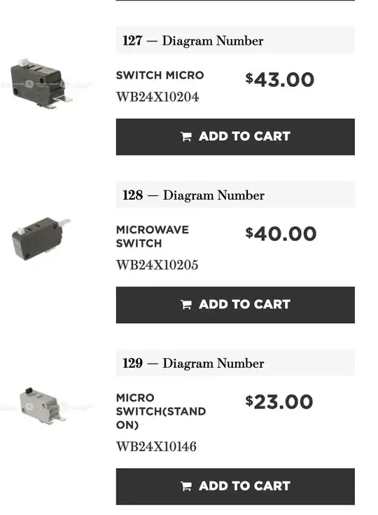

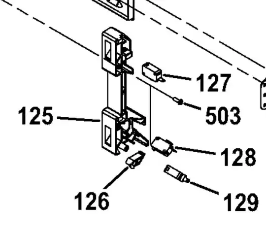

Now here's something that perplexes me: in the GE Parts catalog items 127 and 129 are both "normally open" switches. They look identical but have different part numbers. If you look at the zoomed in photo on each part's catalog page, they are both "K3WA" type that can easily be found on Amazon.
If I remember correctly, in at least 2 or 3 instances, the 128 part (middle, normally closed) switch has failed. And one time the bottom 129 NO switch has failed. Which switch ultimately fails may be irrelevant. As Michael K pointed out, they are probably failing due to the high current burning them out. The real question is why is the interlock shorting instead of simply stopping the cook cycle (the normal everyday behavior you expect when you open the door to stop the micro and get your hot food.)

So I noticed on part 125 the latchboard the latch "ramps" appeared to have worn down a bit which might cause the switches to not all flip in the appropriate sequence. So I purchased and installed a replacement.
When I installed the new latchboard (and new relays) I made sure the latchboard was firmly screwed to the frame. It's possible if the latchboard was loose (I need to unscrew and remove it to replace the relays) it might also cause problems.
I did this mid-November and thus far we've had no more blown fuses. So fingers crossed! I will edit this answer if the problem reappears.

I removed the latch and put a dab of epoxy on the worn "lip" of the latch where it had clearly warn, upper and lower. The worn areas are easy to see if you remove the latch assembly, which only requires removing two screws and a little wiggling. I used a file on the epoxy after it had set up. It's been two months now and it works fine, although we are pretty gentle opening and closing the door.
