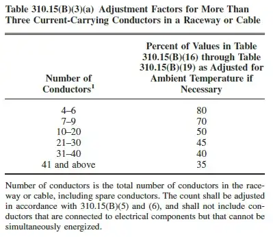

Article 334.80 tells you that you can use the 90°C column from Table 310.15(B)(16) for derating, but the final value must not exceed the 60°C column. If you look at Table 310.15(B)(16), you'll find that 12 AWG copper wire is rated at 30 amperes at 90°C and 20 amperes at 60°C.
Table 310.15(B)(3)(a) tells you that with 7-9 current carrying conductors, you'll have to derate the ampacity by 70%. So with the information from Table 310.15(B)(16), and Table 310.15(B)(3)(a). The math is quite simple.
4-6 current carrying conductors
30 amperes * 80% = 24 amperes
30 amperes * 70% = 21 amperes
10-20 current carrying conductors
30 amperes * 50% = 15 amperes
Which shows that you can have between 7 and 9 current carrying conductors through the bored hole, before the wires are derated below 20 amperes (from Table 310.15(B)(16) 60°C column). Since each 12/2 cable has 2 current carrying conductors, you can figure that only 4 cables can pass through the bored hole (2 * 4 = 8).

(a) More Than Three Current-Carrying Conductors in a Raceway or Cable. Where the number of current-carrying conductors in a raceway or cable exceeds three, or where single conductors or multiconductor cables are installed without maintaining spacing for a continuous length longer than 600 mm (24 in.) and are not installed in raceways, the allowable ampacity of each conductor shall be reduced as shown in Table 310.15(B)(3)(a). Each current-carrying conductor of a paralleled set of conductors shall be counted as a current-carrying conductor.
Where conductors of different systems, as provided in 300.3, are installed in a common raceway or cable, the adjustment factors shown in Table 310.15(B)(3)(a) shall apply only to the number of power and lighting conductors (Articles 210, 215, 220, and 230).
