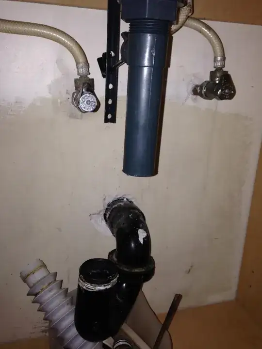

After installing a new bathroom sink, the drain tailpiece doesn't line up with the trap coming out of the wall. I've seen flexible accordion hoses for this, but I think that violates code (P3002.3.1). I live in California. My tailpiece is 1.25" (OD) without threads. The trap is 1.5" (ID) with male threads. What's the best way to do this?
By the way, I have a flexible accordion piece from the old sink, which fits on the trap, but it has male threads on top, so it connect to the tailpiece. So I don't understand how those flexible pieces are supposed to work anyway.

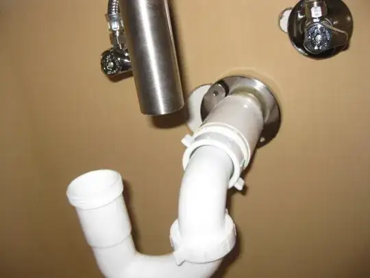

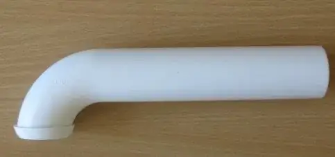

The first thing to do is come out of the wall with a wall tube (otherwise known as a quarter-bend wall tube). Cut the long side if necessary, so it slides into the drain tube in the wall (make sure you have at least several inches in the wall drain).
Quarter-bend wall tube

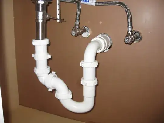

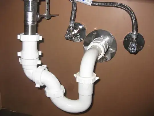

The flange typically connects to the short leg of the J-trap.
First vanity - before

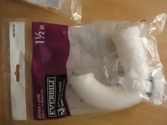

There are two types of J-traps: one with a threaded slip-joint fitting on each end and a "repair" J-trap, with a slip-joint on the longer leg and a compression flange on the other. Use whichever one is suitable for your existing piping.
J-trap
Repair J-trap
The connectors you use depend on two factors: how far is the tailpiece horizontally from the drain connection, and how far above or below it?

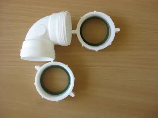

In the above situation, the drain connection is several inches to the side of the tailpiece and slightly below it. To close up horizontal distance, you can use another wall tube cut to the appropriate length, connected to the J-trap. The other end connects to a 90-degree elbow to make the turn and cover the vertical distance. Use a reducing washer to adapt a 1 1/4" tailpiece to 1 1/2" drain piping. (All the components pictured here are from Home Depot; other stores have similar items).

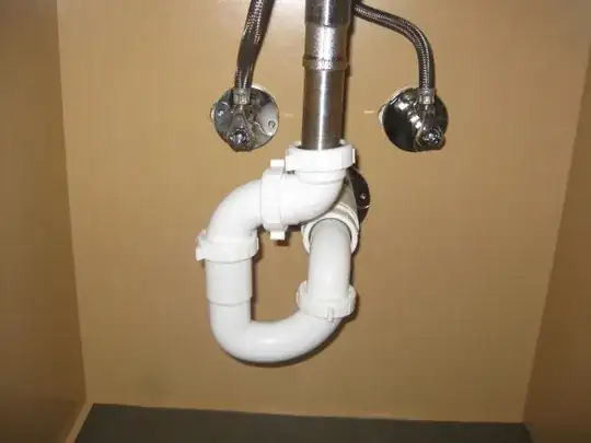

My other vanity has greater horizontal distance and less vertical. Therefore, I connected the longer leg of the J-trap to the wall tube, to get more displacement down, so the connectors would have room to cover the horizontal distance on the way back up. In this case, the 90-degree elbow didn't quite make it to the bottom of the tailpiece, so I had to add a coupling, attached to the elbow with a scrap piece of the wall tube I had cut off.
Second vanity

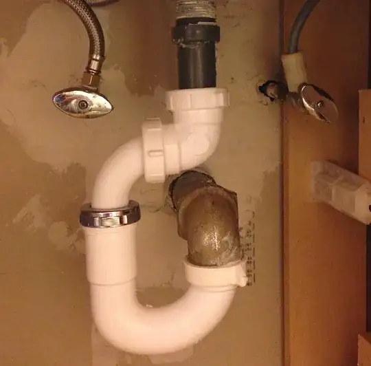

I had the exact same problem under my bathroom sink. Here's a picture of how I resolved it. The first elbow off the sink is 1.5" because I couldn't find a 1.25" female-to-female elbow in my local Home Depot. I used a 1.25" sized compression washer in the larger elbow to get the smaller 1.25" elbow to fit snugly. Works great! You should be able to do the same kind of thing by using the more-available 1.5" pieces whenever you have to and mating them with the smaller 1.25" pieces you may have to use with 1.25"-sized compression washer.

HomeHandyman's post is definitely how NOT to do it. First, the P trap is mounted backwards. The straight down part of the P trap goes under the drain. The gentler, sloped side is the P trap outlet. The idea is the drain water hits the P trap at maximum velocity to help scour/"power wash" the P trap clean. The sloped, outlet side is less likely to hold hair, debris, whatever and keep the drain clear. So that speaks to credibility.
Second, there are maximum heights per code (for a reason!) between the bottom of the P trap and the ultimate wall outlet. In the second layout, there's this ginourmous "U" will drain, yes. But it will be an annoyingly slow drain, and sure to clog over time. Eyeballing it, the second case has water going up at least 8" from the P trap to the outlet. Even the first case has the 90 degree elbow, which drops the P trap outlet below the wall outlet.

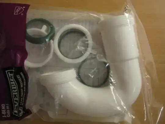

I have never posted to a site like this, though I have used them. I feel compelled. I had a problem with the pipes not lining up for me to use the P trap. I was off by an inch or so. I found this flexible P trap. I have installed it. I hope it works. A rather cheap and easy solution to this problem--if it works and does not clog up. https://www.homedepot.com/p/Everbilt-1-1-2-in-Polypropylene-Form-N-Fit-Flexible-P-Trap-C3522605/205153746
