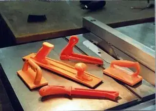

Do not wear gloves while using a bandsaw (or any powered saw, drill press, or planer for that matter). The gloves will give you a false sense of security and do very little to protect your hands. In fact, they may end up getting your fingers pulled into the blade if the material catches. Which would you prefer: a cut fingertip, or a mangled hand?

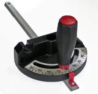

The best way to protect your hands is to be very deliberate about every movement you make around the saw, and keep your hands away from the blade by using a push stick or push block. If the cuts you are making are simple straight lines, get a miter gauge that slides along the miter slot that is present in most band saw tables.
Assorted Push Sticks:
Miter Gauge:

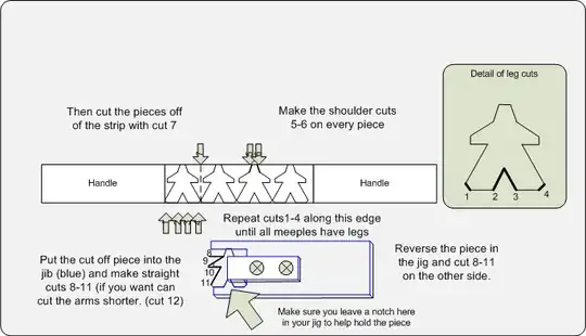

Create a jig to hold the pieces in position for the various cuts. The jig will allow to maintain a safe distance from the blade and if designed well will give you a secure grip on the piece being cut.
Also try to design your cuts for mass production. For example cut the gap between the legs and around the heads while all the pieces are still one long piece of wood. Then cut the gaps under the arms and free each piece from the strip at the same time. You may want to consider leaving 4-6 inches of uncut wood at each end of the strip to give you something to hold on to while cutting the last piece on the strip. When freeing pieces from the strip start in the middle and work each half of the strip to your 4-6" handle.
I've included an image of the cuts I would plan, and a simple diagram of a jig to hold the piece while cutting.
Meeple Jig Diagram

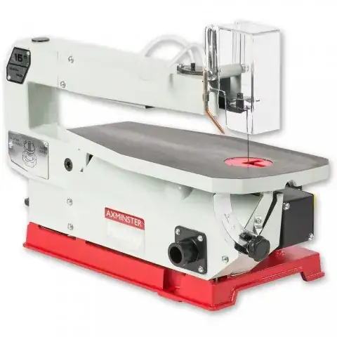

I would really question if a band-saw (a tool that —at varying scales— meat processors use to slice whole cows in half and lumber mills use to process whole trees) is really suitable for such a small and delicate job.
I'm not going as far as saying you shouldn't use a power-tool but there is another option that's a good compromise between the overkill of a powerful band saw and the slowness of the hand tools that others have suggested.
A band saw is going to be fast but come on... Even after safety, consider how many separate cuts you're going to have to make on these little guys.
Personally I'd opt for using a scroll saw with an omnidirectional spiral blade. If you're not familiar with them, they're essentially a blade that buzzes up and down in a fixed position and you move the wood around them.
That does mean the output will be less accurate than some other tooling but that's not always a bad thing, especially when you're dealing with little characters like this.
You can injure yourself on them but if you use the guard you're reasonably looking at losing a bit of fingernail instead of slipping and losing a hand.
The machines are very cheap but you'll probably get through a few blades.
