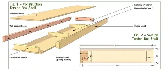

Strong and light and cheap? Take a look at torsion box construction.
Granted it's not exactly thin but as @Joe mentioned, getting all four of those qualities is a tall order.
