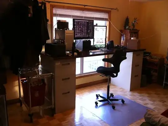

I use 2 3-drawer file cabinets with a 8 foot door. It works really well. Adjustment higher can be done with some 1/4"-1/2" pieces of plywood but the height works well for me. It has the added benefit of storage.

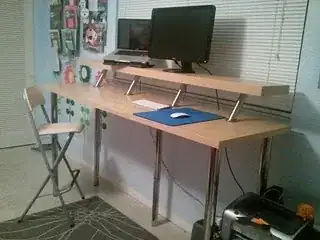

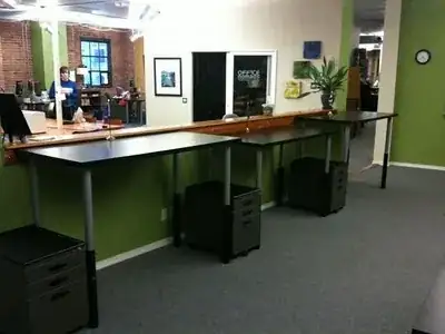

If you're going to create your own legs, there are many ways to do it. Using standard dimensional (2x4 or 4x4) lumber would be one way. A relatively easy way that comes to mind is to use Ikea stuff - they have many desk parts, including adjustable legs. If they don't go high enough for you, you could always build a mount from plywood/dimensional lumber to give an extra foot or so on the bottom of the desk, them mount adjustable legs to those.
Here's a couple things to help inspire you from Ikea hackers:

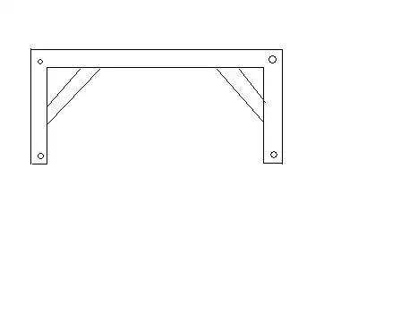

Obviously you're looking for the Really Cheap™ solution.
At the minimum, I would put a spreader across the two back legs. I'm thinking of a 2x4, drilled to 1" depth to receive the legs, and then bolt these to the tops of the milk crates.
A better design would have two more spans, across each end, and then angle brace it to the rear support.Quick and Dirty MSPaint
At this stage, you could look for better options to raise it up.
