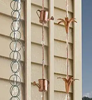

Replace the downspout with a decorative downspout chain. Then water only drips inches to the next link, rather than all at once, the height of your downspout.
Downspout chains
