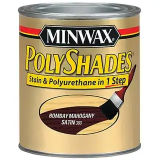

The can says it all. Personally I don't like it but landlords love it. Left with 40% usable material there's not much you can do except replace it all. Multiple rooms worth of salvage may make up for one of them. Reading your other post, this trim was recently reattached, making it rather impossible to remove without destroying it. This product requires only a scuff sanding to bond well, all reasonably done in place.
