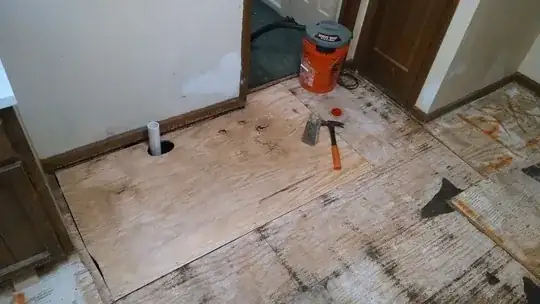

1) You need to lay down a layer of plywood. A half inch is good, but 3/4 in is better. IIRC, modern building code calls for 3/4 in. plywood. Screw it down and make sure there are minimal gaps. In the picture below, I had to replace a lot of plywood because some of it rotted through due to improper tiles laid before.
If you plan on any drains, toilet connections, or any other holes in the floor, try to figure out where they will be and make a approximate hole. If it's a little larger than it needs to be, it's not a big deal. Your plywood should be close but doesn't have to perfectly 100% nanometer precision fit your floor area.
Make sure your plywood doesn't move, creak, or slide around. If it does, rip it up and do it again so it doesn't. Bad subfloor = bad tile job = you fix it now, or you fix it in a few months/years.
Note: I took this picture part way through replacing the plywood. Laying Plywood

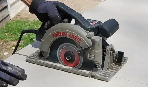

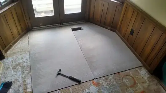

You will need to cut your hardie board to fit as close as possible your entire floor. It is easier to cut strait lines with a masonry circular saw blade. You can use a masonry blade on a handheld jigsaw to do more precise cuts. You can also score and snap cement board. Be careful though, cement board is brittle and it can snap easily, sometimes too much! (That means start over). Also, you don't want to line up the seams on your cement board with the seams on your plywood. Try to overlap them by at least a few inches if possible, and try to use large pieces of cement board, not 1,000 tiny pieces.
Skillsaw on cement board
IMPORTANT!!!! Cement board cutting makes a lot of dust. It goes everywhere. I recommend cutting OUTSIDE!

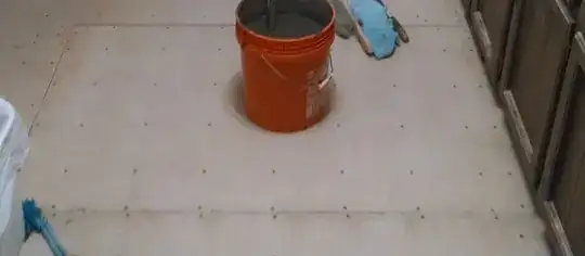

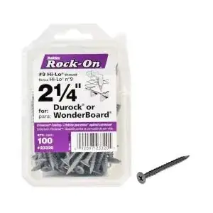

Once you have your boards all cut out, screw them down using cememt board screws (There is almost always a display case of them next to the cement board.
Cement Screws
These are not drywall screws. They are not made of metal, so they cannot rust. They are self drilling (So you don't have to make 1,000 holes).
Put a screw every 6-12 inches, so that you have a nicely dotted floor. Extra screws won't hurt, but be gentle when putting them in near the edge of boards!
After screwing down

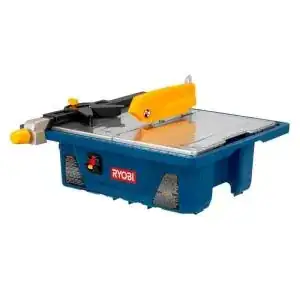

Cut your strait cuts using a wet saw (Or tile score and snap machine). I won't get in depth here, but be sure if you use a wet saw not to ever turn the tile mid cut. (Blade will shatter into a million pieces.)
Wet saw

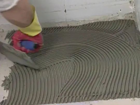

When you are sure you are ready to begin, scoop out cement on the floor, then make nice arcing shapes in it like below:
Cement lines
If you have a really tiny or awkward shaped tile (Or not enough room to fit the trowel) you can put the morter right on the back of the tile. The morter should hold the shape of the trowel. Don't pour too much at once or it will dry before you get to it.

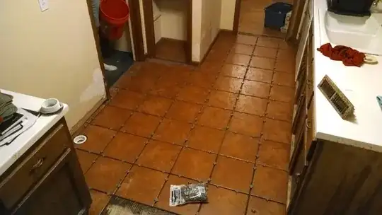

Remember to put down your tile spacers as soon as you finish placing the tile. You should also be sure to put some weight (Don't stand on it if you can avoid it) on each tile, to make sure it gets a good connection with the morter. Try to level and evenly space your tiles (You cannot change it later). If a tile doesn't stick or slides around really easily, rip it up and do it again, or risk a compromised floor. If you take a break, clean up any cement along the tile edge and then you can come back later!
If all goes well, you can pull up your tile spacers and the floor should look like it's coming together!
After cementing
Once you finish laying all the tiles, let it dry for 24 hours. Don't walk on it for at least 16, and avoid any heavy traffic.

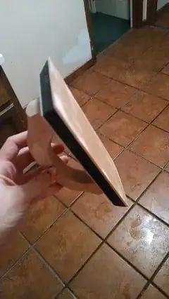

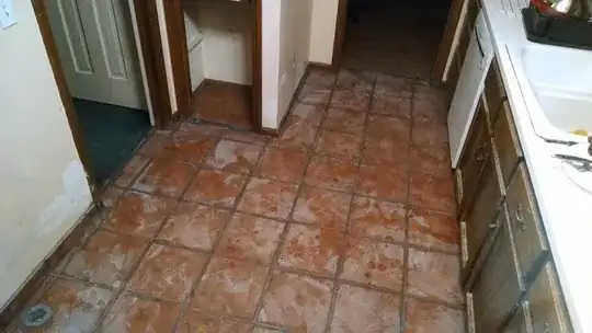

5) Time to grout! Get your grout float, some more junky clothes, and mix up your grout.
Grout Float
Get some grout out and mush it into the cracks. Make sure you really push it down, not just "graze" it over them. You want to then use your grout float to remove the excess grout sitting on top of the tiles. Don't worry if your grout lines aren't perfect. Our goal in this step is to lay the grout, not perfect it YET.
Grouting
Done with grout? Great! DON'T TAKE A BREAK YET! (The grout will set up, and it's game over. I made this mistake once, and it took me 8 hours strait to scrape the mostly dried grout.) You need to get out a clean bucket of water and a sponge, and "wash" the tiles. You will wipe off ALL excess grout, and use the sponge to make your "perfect grout lines". Don't press to hard or you will ruin the grout lines. Try to push even and make it look nice!
Washing the tiles
All done? Nice work! Go back and make sure you didn't miss anything ;)

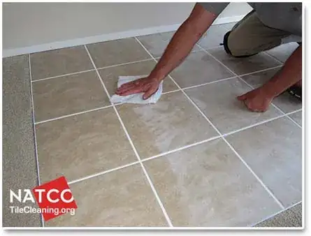

6) After the grout has dried for two to four hours, it will get cloudy. Use a DRY cheese cloth to wipe away the haze. (Repeat after 1 more hour)
