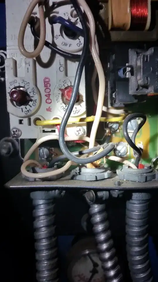

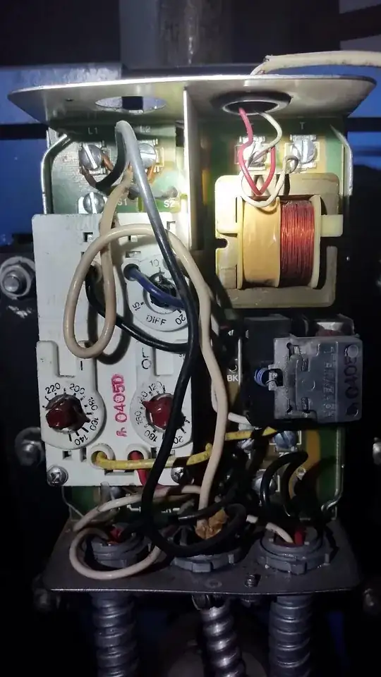

The new thermostat I purchased doesn't run on batteries, and needs 24 volt power. I have only a red and a white wire connected between the boiler and the thermostat, but there is also a third, unused wire. The instructions from the thermostat say to hook that third wire to the C terminal on thermostat and to the furnace's C, but I have a boiler with no C. Where do I put it on here? Please help I'm desperate.
pic 1
pic 2
Mike N
Unfortunately, the Aquastat you're using does not expose a C terminal. The transformer is likely soldered directly to the board; so unless you're good with a solder gun, you're going to have to buy a different thermostat.

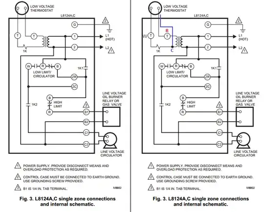

The red wire attached to the T terminal, should be connected to the R terminal of the thermostat. The white wire attached to the T terminal, should be connected to the W terminal of the thermostat. When the thermostat calls for heat, it will connect the R terminal to the W terminal. This will cause the coil to pull a switch closed (relay), which tells the boiler that the thermostat is cold.
If you're not afraid to potentially break things, and you really want to try to get the new thermostat working. You could try to add your own C wire. You'll simply have to connect the new C wire, to the other lead of the secondary coil of the transformer.
Left image shows original wiring. Right image shows where the C terminal should be added.
WARNING:
Modifying the wiring of the Aquastat will likely void the warranty, and could potentially damage the equipment. Proceed at your own risk.

If those red and white wires are wired correctly, the +24v 'R' terminal should be the red wire in the upper right, that is under the 'T' screw. Do NOT mess with either of the (12g) wires in the upper left, under the L1 and L2 terminals. Shut the power off to the unit before you go poking around in there.
The C terminal you're after does not seem to be user accessible; it would be one of the solder joints on the back of the circuit board the transformer is mounted to, as old boiler controls weren't designed to supply auxiliary 24v power. I'd have to ask if it is OK to achieve a low voltage ground by attaching it to the control box with a screw. I lack the experience necessary (and the schematic/number for this control) to even attempt to say one of the other terminals on it might work for you, safely.

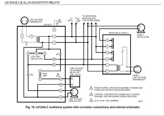

This doesn't make any sense to me, the thermostat just shorts out the transformer after it goes through a resistor. (top left)
Source of the picture and some good boiler talk.
The manual for a L8124A.
