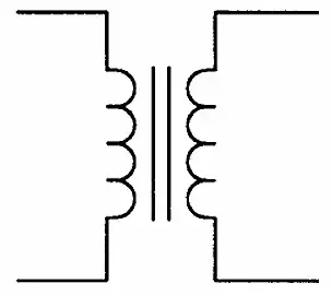

Find the transformer on the schematic
Once you've located the diagram, you'll want to look for this symbol.
Or the actual text that says "Transformer", which may be labeling a crudely drawn transformer, or simply a rectangle.
Primary or secondary?
After finding the transformer in the diagram, you'll have to determine which wires are connected to the primary coil, and which are connected to the secondary coil. Check the diagram for a key, which will give you a hint. On some diagrams a thicker (bold) line denotes line voltage wiring, while a thinner line represents low voltage wiring. Others may list the voltage and frequency on each side of the transformer.

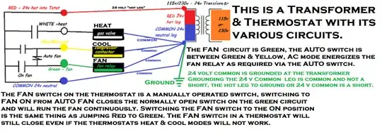

Trace the wires
Now that you know where the transformer is on the diagram, and which side is the secondary. The next step is to follow the lines, and see where they go.
Example diagram
In this example diagram, you can see that one leg of the secondary connects to the R terminal on the control board, and the other leg connects to the C terminal. In this example there's actually a C terminal present, but that will not always be the case (especially in old models). However, even if there isn't a dedicated C terminal, that doesn't change what the C wire is. Which is simply the other side of the secondary coil.

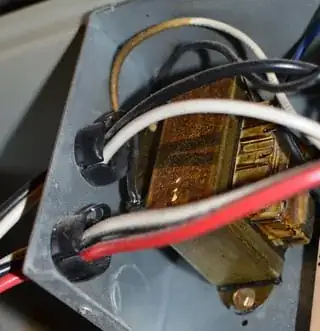

In Real Life

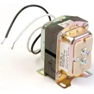

Now that you've located the transformer in the diagram, or maybe you don't have a diagram. Either way, you'll have to locate the actual transformer inside the HVAC unit. You'll be looking for something that looks similar to this...
Honeywell 24-Volt Transformer Model # AT72D
Honeywell 24V AT72D Transformer
My Transformer
An action shot of the actual transformer in my furnace

Common leg of the 24 volt control circuits is grounded, Red is not. Common is the side of 24 v power that every 24 v circuit terminates to complete its circuit.
