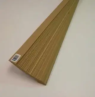

Get a long straightedge and a pile of drywall shims. High joists are pretty easy: add shims to bring them down to flat with the others. Low joists require you to build up the adjacent joists gradually over a few joists to meet that 1/8" (or 1/16").
I attach the shims with staples, but many people like to glue ceiling wallboard in place, to prevent dimples at the screws/nails in the future. If this includes you, then the shims should also be securely glued.

36" Drywall Shims: (menards.com)
