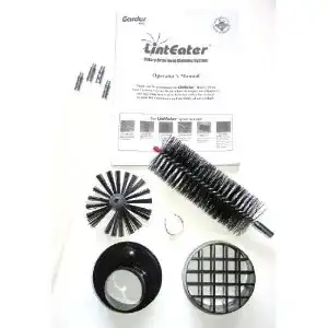

You can probably do it yourself cheaper than hiring it out. You could try something like this vent cleaning system. It seems to have fairly good reviews on Amazon, and for $25 it's worth a shot. It claims to have a 12' reach and the ability to navigate turns in the vent, so you may have to go at the last 3' from the other end.
Note: You'll need a drill to attach it to. A shopvac would also be helpful, but if you don't have one, the kit includes an attachment to use with your dryer.

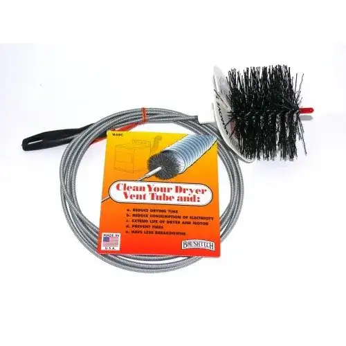

The standard thing to clean a dryer duct is a brush with a long flexible handle. They make ones specifically sized for dryer ducts. Here is a typical one:
Picture of dryer duct brush
Disconnect your dryer and push the vent into the duct. Run it back and forth a few times. Keep a vacuum handy. You will make a mess.
If your duct is vented somewhere on the ground level, you could easily sweep from both ends. Since it sounds like yours vents to the roof, you will probably want to sweep from the inside only. However, you should probably check out the outside vent to make sure it isn't plugged, and opens/shuts properly.
If your duct has a lot of sharp bends or is very long (longer than the brush handle can reach), you will need to disconnect sections of the duct and clean them individually.

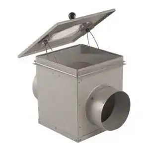

I know you already have this problem and are asking about clearing it up. However, to prevent this from happening in the future, consider installing one of these lint traps near the exit of your dryer:
Picture of lint trap
I have one and it seems to work very well. You'll need to pop open the top and clean out the lint every few weeks depending on how much drying you do.

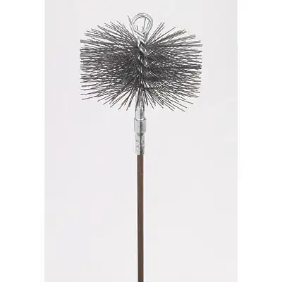

If it doesn't bend, then you could use a chimney brush, which is essentially a long stick with a wire brush on the end.
Chimney Brush
