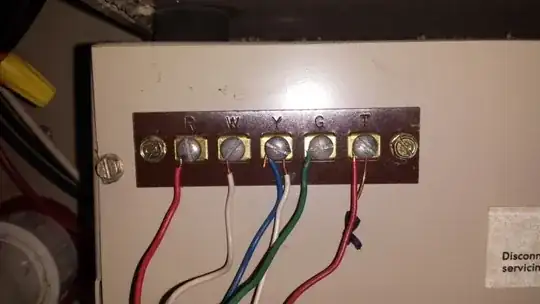

I've read many posts on this, and believe I know what to do, but want to make sure. My furnace (a Lennox G14 Series) does not have a C terminal which needs to be connected to the C terminal in my new wifi thermostat. In the attached picture of the terminal strip in the furnace, the red wire on the T terminal and the white wire on the Y terminal go to the air conditioner. The other 4 wires go to the thermostat. I've measure across the R and T terminals and get 28vac. Based on this I believe I can use the T terminal for the C connection...is that right?
Eventually I'll run a 5 wire cable but for now I plan on stealing the green wire to make the C connection if I can use the T terminal.

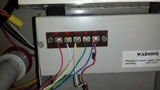

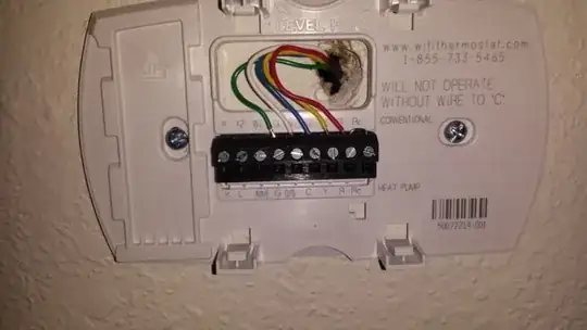

SOLVED (01/04/15): I decided that the T terminal was exactly what I needed so gave it a try and everything is working perfectly. I also pulled in some 18-5 thermostat wire. Here is my setup, in case it might help someone else:
Furnace: Lennox G14Q3-60-13
Thermostat: Honeywell RTH6500WF
I've attached pictures of my connections.

R wire is power supply hot
C wire is power supply common
W wire is furnace heat ignition relay (heat)
G wire is furnace fan on/off (heat)
Y wire is air conditioner fan on/off (cool)
If using an air conditioning compressor unit,
  • add 1 wire from furnace terminal block label Y to the a/c compressor relay hot,
  • add 1 wire from furnace terminal block label T to the a/c compressor relay common
Lennox terminal block inside the furnace uses T label on the terminal block for common, as shown in your electrical wiring diagram.
Older thermostats did not need a constant source of power for the thermostat display, so the C wire was typically not used.
Modern thermostats which have backlit displays, wifi etc., require a constant source of power and therefore require the C wire to be connected to the power supply in the furnace terminal block, to allow the flow of constant power to the thermostat.
