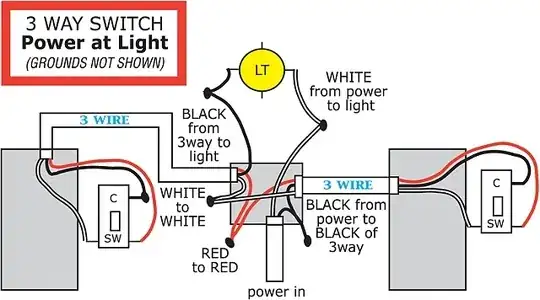

This diagram shows 3-way switches with power entering the light fixture box, and seems less confusing than many. It's surprising how many mislabeled diagrams of 3-way switches there are out there:
enter image description here http://cindyjerrell.com/artwork/2012554_3_Way_Switch_Wiring_Diagram.html

There are different ways to physically wire up 3 way switches, depending on whether power enters one of the switch boxes or enters the switched fixture. But they all add up to exactly the same thing.
You have 3 terminals on each switch. The different-colored one (usually darker) is the common, and the other two are "travelers."
So you have 2 travelers. This is usually the red and white, if your wiring is NM/Romex 3-rope, and you would use a black permanent marker or wrap black tape around the end of the white wire to indicate it is a hot conductor (not a neutral) in the switch circuit.
It sounds like you have something other than NM 3-rope going on in the wall between the light fixture and one of the switches (not the end of the world--electricity doesn't care about the color of the insulation on the wire).
The travelers always run straight between the same-colored terminals on both 3-way switches, no other connections
Depending on the positions of the switches, one of the travelers is always hot.
If the switches are positioned so that the common on both ends is connected to the hot traveler (which could be either traveler), then the circuit is complete and the light comes on.
The purpose of the travelers is to complete or break an electrical connection between the common terminals on the 3-way switches.
Now that the travelers are out of the way (connect them to the two same-colored terminals on the switches, forget about them), consider the common terminals...
Regardless of where the power enters the circuit, you run your hot wire to the common terminal on one switch, and wire the hot lead on your fixture to the common terminal on the other switch.
The entire set of 3-way switches, as a whole, just switches the juice on the common terminal of the 3-way switch at the opposite end.
