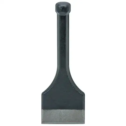

Step one, which I hope you are already doing - put on a pair of safety glasses. You may also want earplugs, and gloves.
Use a masonry chisel (nearly parallel to the floor) to get under it and lift it up. You can also drive it into the grout joints, but if you already have a few tiles out, driving under the remaining ones from the area where some are removed is usually more efficient.
Picture from harbor freight - no association and no endorsement implied.
