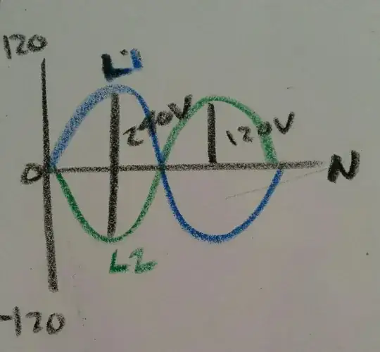

The two sine waves should look something like this.
sine waves from single split phase transformer
Because the waves are phase shifted 180°, the electrical potential between the legs (at the peak) will be 240 volts. While the potential between either line and "neutral", will be 120 volts.

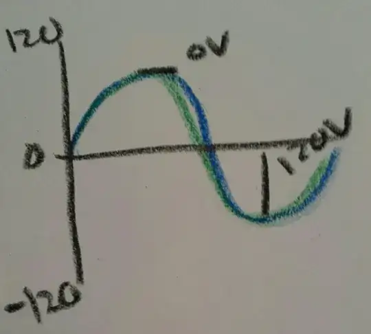

If the waves were not phase shifted, they'd be at the same potential (or have 0 volts between them).
in phase sine waves

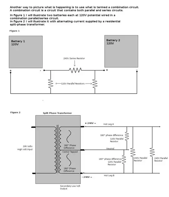

Edit: Here is a recent diagram I made to help illustrate the concept. enter image description here
