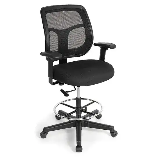

As an alternative, you could consider what I've done. My desk at the office is electric (I found a good source for electric desks at economical prices and we have several of them). But at home, I raised my entire desk up on blocks so it is at standing height, then got a "drafting stool" style of chair--basically an office chair with a longer gas tube and a foot ring.
