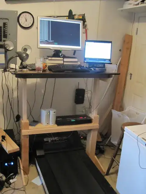

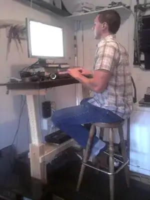

I've built this desk twice. It costs me ~$100 USD in materials:
And here is my version of the desk:
You can adjust it, but it is a little difficult. However, you can fit a modified treadmill under it as you can see in this video of me using the desk. I'm able to type comfortably while walking at 2.2 MPH.
If I may presume that the reason you want a height-adjustable desk is so you can sometimes sit and sometimes stand ( or walk!), then take the idea of height-adjustable and flip it on its head. Just buy a tall chair instead. (I only have a stool at the moment):
Usage
I have a height adjustable desk at work ( not ghetto'ized, like my home version). The linear actuators for my desk come from LINKAK:

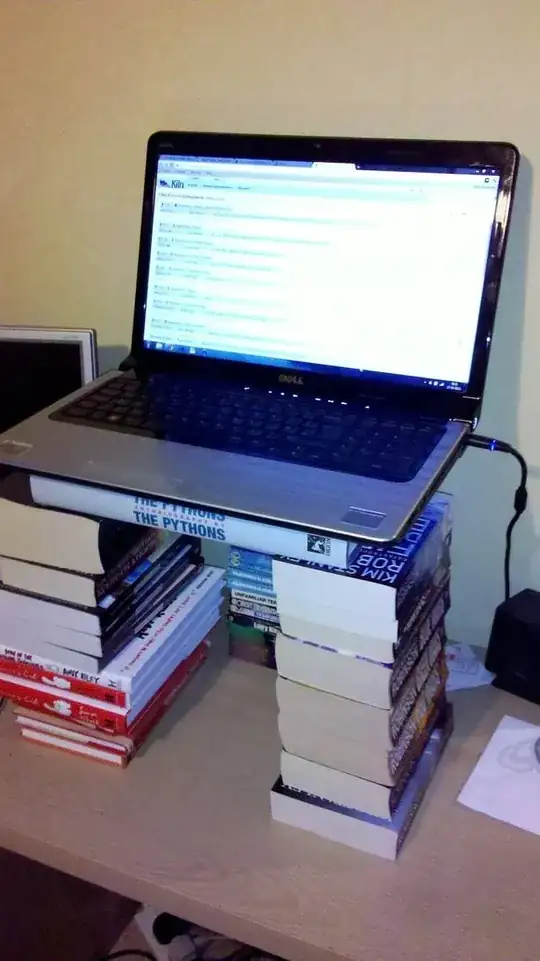

I recommend Kim Stanley Robinson's Bibliography, fleshed out with some Frank Herbert, and a large solid hardback for the top; I'm using 'The Pythons' in the case, but gardening and DIY manuals are equally good candidates.
Fine tuning can be done with Asimov, Van Vogt, Niven, or Simak. You may be tempted to use Ian Livingstone and Steve Jackson, but they're not very good for this purpose as there is too little variation in size.
My setup is particularly quirky; due to my number pad I use the left of my keyboard more. With this in mind I've bolstered the left stack with Simon's Cat, The Bunny Suicides, and similar comedic hardbacks.

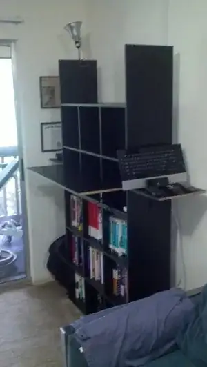

Pricing it up it seemed cheaper to get a second pair of monitors and a video switch - then build a separate low and high desk with regular IKEA parts - and simply stand / sit in front of each

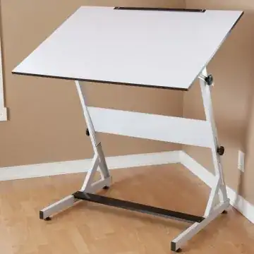

I'm a programmer and I currently use a drafting table as an adjustable standing desk. I wanted something that I could use in both sitting and standing position. The table I'm using is similar to the model shown here:
I can adjust the height by loosening the knobs and sliding the upper section upwards. The tabletop can be adjusted to be horizontal. This is working reasonably well and is a fairly cheap solution (actually, I found the table in a store room of our offices, but I have seen similar ones on the net selling for around $150)
There are some negatives, as it's obviously not designed for these purposes:
  • The top end of the range of adjustability is slightly lower than I would like. I'm fairly short so it works out OK but it would not be high enough for a tall person. I have to use monitor risers on top of it to bring my monitor up to eye level, but the keyboard height is about right.
  • It has a bit of a bounce to it when you are typing, if it is fully extended. I place a tripod under one of the front corners to stiffen it up when using it standing.
  • It's somewhat cumbersome to raise and lower with monitors on top, though I have still been doing this an average of once a day. My co-workers usually look at me with a look of concern and imply that I'm going to injure myself. I get underneath and hold the tabletop up with my back to control the ascent/descent while holding both knobs with my hands.

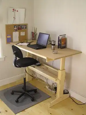

This is the finished project for my adjustable height live edge computer worktable: Finished Live Edge adjustable table
