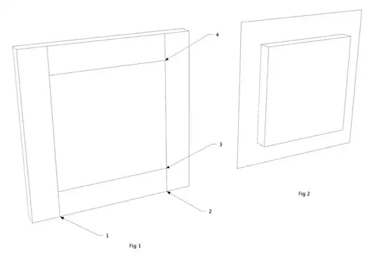

A hole that size should be taped to prevent cracking. You don't need to use tape though. Another method uses the patch piece of drywall's paper:
  1. Square the opening to be patched.
  2. Cut a pice of drywall about 4" x 4" larger then the hole.
  3. Score the back side of the patch piece of drywall along lines 1 & 2, about 2" in from the end.
  4. Place the drywall face down on a table, lining up the score line with the edge of the table and snap it along the line.
  5. Repeat steps 3 & 4 for score lines 3 & 4.
  6. Peal the outer edges of the drywall off leaving just the front paper so that your pice looks like fig 2.
  7. Place the patch pice over the hole and mud.
