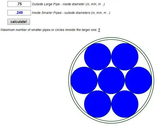

This depends on whether you are using pre-assembled cables or not. The following images were made using The Engineering Toolbox's Smaller Circle in Larger Circle Tool to find the optimal packing.

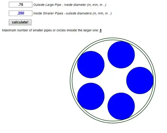

If using bare cable (No Connectors)
Using a 6.5mm (0.256) Diameter cable, you can fit only 5 cables per conduit. 0.256" Dia cables
However, this assumes the cables are perfectly circular and non-deformable. If you assume you can deform the cables, or you use a slightly smaller cable, you can fit up to 7 without destroying the cables. 0.249" Dia cables

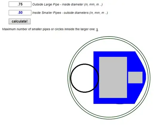

If using pre-assembled cable
However, you will likely be using connectorized cables. Assuming a 0.5"x0.5" connector head (I measured one I had laying around), you'd be lucky to fit 2. 0.256" Dia cable with connector

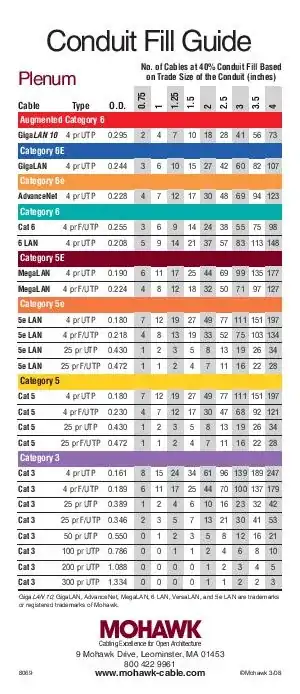

When it comes to data (Cat6) cable it in not so much about the number of wires you can fit in to the conduit, because the more you get in the conduit the more the speed of the information could degrade. I have always put no more then 4 Cat6e in a 3/4in Conduit. So pick the best cable for your job and then the correct size of conduit or run more then one 3/4in.
The following is from, http://www.datcominc.com/edit/files/catalogues/Mohawk%20Conduit%20Fill%20Guide.pdf
Mohawk Fill Guide
