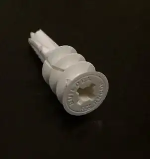

Select Quality Deep Thread Screw-Type Anchors
Forget about toggle anchors: The toggles are so bulky and the bolt patterns so crowded that the toggles will usually interfere with one another and whatever happens to be behind the drywall.
Sheetrock only has strength because the gypsum is under compression. The gypsum is under compression only insofar the paper (yes the outside of drywall is paper) retains its tensile strength and gypsum does not leak out. These anchors, used correctly, work without compromising these critical aspects of the sheetrock:
anchor picture
Note how the anchor's threads achieve a large contact area with the gypsum and have deep threads. Note also how the head and barrel of the anchor seal against the paper to keep the gypsum in.
When these anchors are installed correctly they do two critical things to preserve the integrity of the sheetrock:
  1. They stretch the paper around the barrel preserving the paper's tensile strength.
  2. Their barrels displace the gypsum slightly into the surround area thereby preserving or slightly increasing the compression of the gypsum.
If your method of installing the anchors doesn't achieve these critical things, you need to re-think your approach because the anchors won't hold.

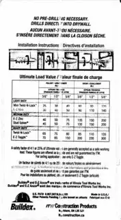

For reference, here is the data on the anchors I use (I got them from Home Depot):
front of box back of box
Note the table of shear and pullout strengths -- these are quality engineered anchors. Installed correctly, they have real usable anchor strength.

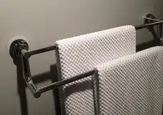

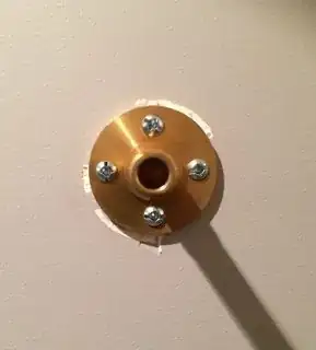

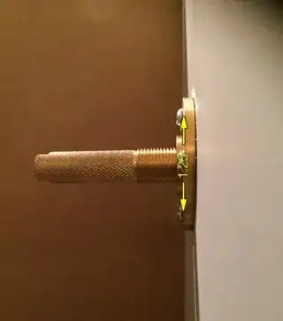

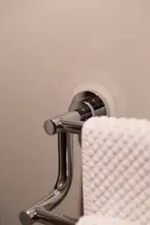

Here is what one of my installations look like:
left hand mount point mounted towel bar
Note that even though the towel bar is overhung about 6", the mounting is plenty strong enough. People knock their elbows on it and grab it to steady themselves without a problem. This works because the load is distributed across 8 correctly-installed anchors for a combined pull-out strength of about 640 lbs and a shear strength of about 960 lbs. At that strength, the weakness is the sheetrock itself, not the anchors. In other words, to break this mounting you'd have to apply enough force to tear a whole section of sheetrock off the wall.
