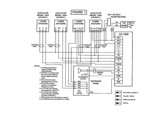

Wiring diragram My transformer is in the (finished) basement on the west wall of the house; the intercom stations are roughly in the center of the house, and the door is on the southeast side of the house. All wires immediately go behind sheetrock.
I haven't been able to find the AF-1000 master unit anywhere in the house, though i know that it is somewhere in there.. Is there a procedure that I can use to find it short of ripping out all the sheetrock to trace the wires?

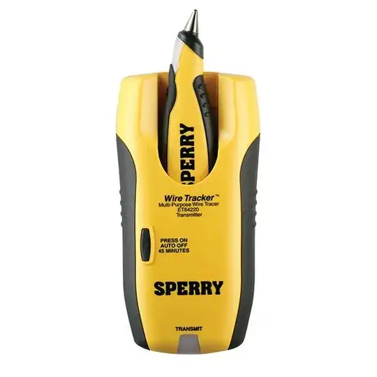

You should be able to use an inexpensive wire tracer to follow where the wires from any of the stations are going. Even the cheap wire tracers will work through sheetrock.
