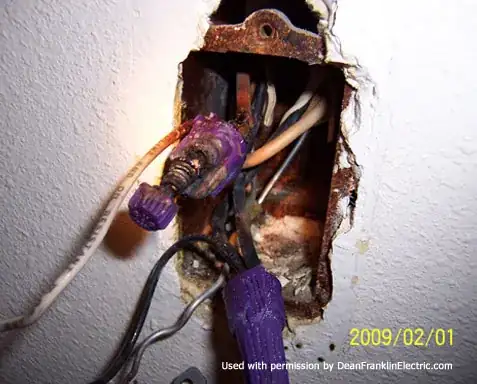

Fast forward 10 years, and one stopped working. Pulling the plate, I had a melted purple nut, like the one above. And found that Lowes and Home Depot no longer carry them (banned?). I bought a couple of the even more expensive push-wire connectors and installed.

I know this is a very very old post, but I thought it was important to explain the reason behind the marrett failing in the picture so people that find this via google images dont jump to conclusions. This was installer error, as you can see there was no PRE-TWISTING of the wires to ensure a secure connection. The issue here was a loose connection, leading to arcing, which melted the marrett. I work for insurance companies and see this all the time.
THIS IS WHY YOU PRE-TWIST YOUR CONNECTIONS AND SQUARE OFF THE END.
