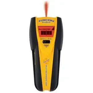

To help, get a stud finder that also includes detection for metal wiring and pipes. They aren't fool proof, but when they do find something, they can be a life saver.
stud finder
