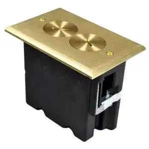

While I can't think of a good way to get the wire into the wall, you could install your outlet on an adjacent wall, or you could go for a floor mounted outlet as a last resort:
