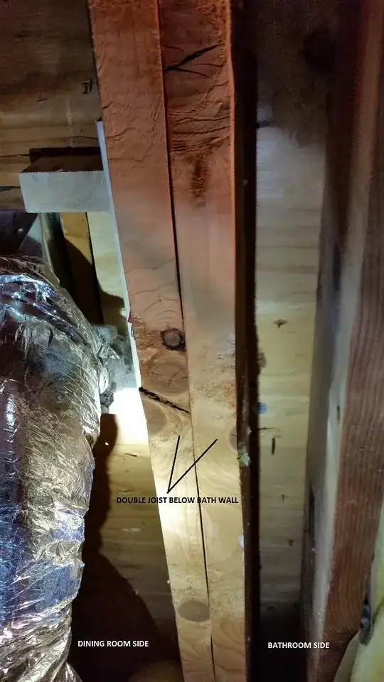

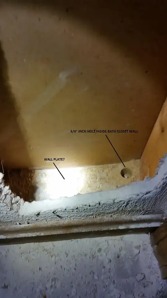

I started to drill (3/4" paddle bit) before I realized that the bath closet walls sit on double joists. Perhaps this is because the baths are almost in the center of the house. Also the drill depth seemed more than I expected (extra stacked wallplate?), which is why I stopped and re-examined the basement (I had my orientation wrong before I started and did not realize the double joists were right underneath).
So I am trying to figure out the best way to go about this. I noticed that what previous contractors had done to run wires in the cavities above the double joists was to drill diagonally(?), then vertically. However, I expect that to be a lot easier for a single power cable and harder for a bunch of 8-14 data cables.

Double joist below bath wall Bath closet wall

See this answer for more information on drilling through joists.
For your case specifically, you're able to notch (and angle drill) at a depth of D/6 and a width of D/3 at a time per joist as long as you are notching in the first or last third of the joist.
IRC R502.8 Drilling and notching.
Structural floor members shall not be cut, bored or notched in excess of the limitations specified in this section. See Figure R502.8.
