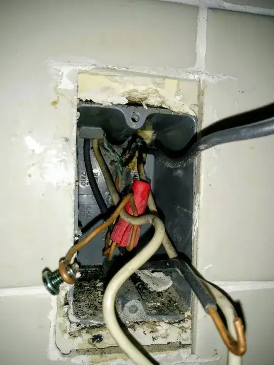

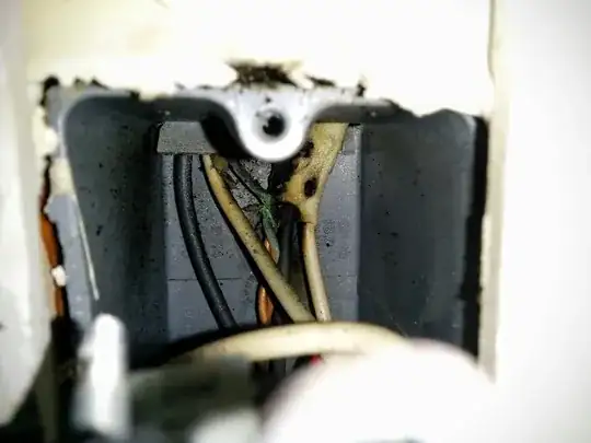

I heard buzzing and popping noises behind this kitchen outlet so I opened it up and it looks like this:
burnt wires
burnt sheathing
What might've caused this? And to repair this, do I have to cut up the drywall and replace the wires/sheathing? Or just wrap whatever is in the box with black tape?

"What might've caused this?" I see obvious arcing under the sheath, it looks like water intruded and high current from the black conductor, through a nick in the black wire insulation flowed to the ground wire. These nicks happen when carelessly cutting the sheath. Once that current started flowing, perhaps the insulation melted enough to establish the arc, as you heard.
"And to repair this, do I have to cut up the drywall and replace the wires/sheathing? Or just wrap whatever is in the box with black tape?"
Somehow new wire must be run because the spot with the arcing happened must be eliminated. That arcing ate away from the conductor.
Sometimes the box can be removed and wire fished through the wall.

The best thing to do is set yourself about 2 hours of free time, turn off the power to any wire near that box (use one of those electric sensors), make sure you have a flash light, around.
First, pull as much of the wires free as you can, restrip everything and get new caps and tape everything new. If you think or even suspect another shitty splice is outside the box then yes, break through the drywall and make sure you tape and replace any splices there as well.
edit: ha, just saw that's not drywall...well tile is not as easy to fix, but honestly it's not that bad either...just a bigger project.
edit: am I seeing water damage (the green on the copper and debris in the box?) Just make sure there's no water leaking in your wall....
source: own several very old houses - I do this everytime I change a ceiling light - they are just masses of cloth tape and garbage...
