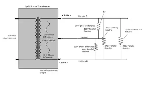

A single split-phase center tap transformer supplies most homes in the USA as 120/240V. Condominium homes are generally 3-phase WYE 120/208.
With a center tap split-phase, the secondary sinusoidal wave is physically split in to two 180° halves by the neutral.
Thus, on a single split-phase panel there are two busses that are designed to distribute the loads/breakers as equally as possible....but much of the load balancing is fined tuned by the electrician during the installation, as lights generally have much higher loads than outlets.
Have a look at this answer for more information and illustrations. *Note: the link is mainly about split buss panels but may be relevant for your question.
The illustration below shows the basic wiring of the common single phase transformer and how it supplies individual appliances in a home. Note how the single phase is split in to two 180° potentials with the neutral at the zero potential. enter image description here
