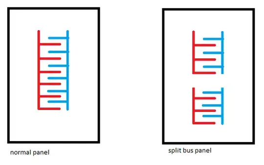

Imagine a 2-phase sub-panel: 2 bus bars down the middle, 2 lugs at the top to connecting the incoming power from the main panel. (No main breaker here because this is a sub-panel; the disconnect breaker for this type of panel lives in the upstream panel.)
Now imagine a sub-panel that contains 2 completely independent sets of bus bars. This is a split bus panel.
Here's a picture:
normal panel vs. split bus panel
Typically, in a split bus panel, the wires delivering the power to the panel are connected directly to the lugs for the upper bus. Then a double-pole breaker is installed on the upper bus and wired to the lugs on the lower bus.
split bus panel wiring diagram
This is allowed because of the "6 breaker rule", which says that a panel must de-energize all of its circuits by switching off at most 6 breakers. Provided that the upper bus has at most 6 breakers installed (say all double-throw breakers for big appliances) and one of those 6 is the double-pole powering the lower bus, then it takes at most 6 breakers to de-energize all of the attached circuits for the entire panel.
So you can identify a split bus panel by looking in the middle for a (ahem) split bus. It should be obvious because there are lugs buried between the breakers, and those lugs are likely wired to a breaker above.
