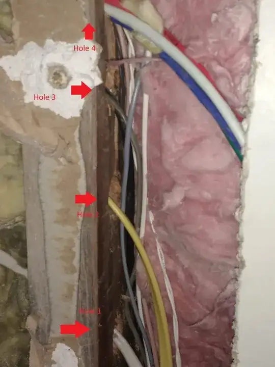

Anyway, I am trying to figure out what the best way of routing all of these wires would be. I had to rip out the drywall because the wires were stapled to the frame when the house was renovated in the early 90's so my only option was to cut into the drywall to unstaple them. So I was able to take a good look at what is going on behind the walls. There are a whole host of "alarm", telephone, and COAX wires running DIRECTLY on top of the Romex. This was likely done by the lazy alarm installer technicians AFTER the electricians did there work in the 90's. I am pretty sure that is not to code to have low voltage wires run through the same hole as 110v. I want opinions on the best practices of how I can go about "cleaning" this mess of wires up. I noticed that when we run our portable space heater in the upper floors, the 14 gauge Romex gets luke "warm" which I don't particularly like.

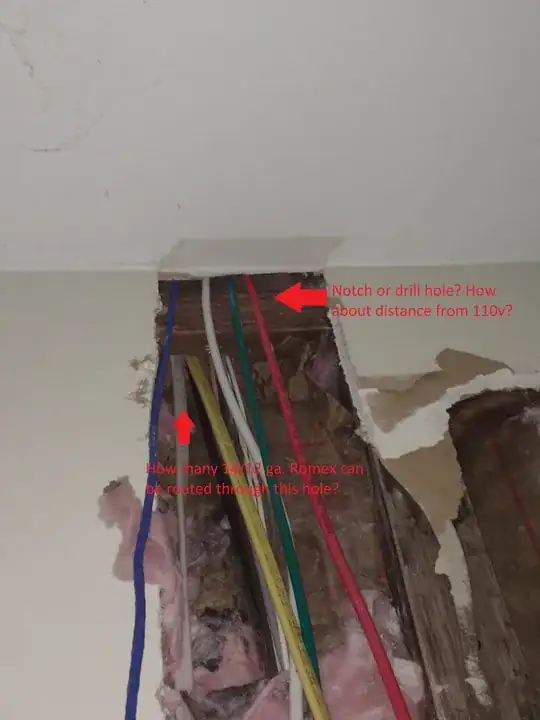

Finally, I wanted to know if it would be okay from a structural standpoint to drill an additional hole through the header joist for the front facade of the house between the first and second floors for the network cables and new Romex runs. Or would it be OK to put in a notch with some nail guards?
Here are some photos of the situation. I would just like to get some professional opinions on the matter. Pictures:

Passing over a stud: (this happens due to the fact that the wires run behind a closet on the second floor. I could technically bypass this and go straight up but I'd possibly have to knock down more drywall on the second floor. ) Crossing over a stud
Going up to the second floor: (the network cables just "float" past the header joist and do not go through it at all) Going up to the second floor

From a functional point of view you really don't have to worry about separation. Twisted pair is actually quite good at ignoring noise, and 60 Hz noise is of little note to 100MHz ethernet anyway. You can do it all wrong and it will work, 99% of the time. I don't suggest that you do it all wrong, I do suggest that you don't freak out about it.
From a code (and safety) point of view you should not have low and line voltage going through the same hole, and from a hyper-cautious network standpoint they should be separated by a good 12" when parallel, or cross at 90 degrees if they need to cross. Separation matters a lot more in an industrial environment with noisy devices on the powerlines than in a typical single-family residence.
From a "best practices" point of view, network and power in separate stud bays (when running vertical) or between different sets of joists when running parallel to the joists is certainly a best practice, though not required by code - it maintains separation quite aggressively.
Notches are far worse than "holes in the center third" (top to bottom) of a beam, joist, or header. Holes should not be too close to the ends, even in that center third. I'm not sure there's any need for the cables to go through the header if they can "float by" (remember, I'm flying blind here)
Portable electric heaters are nasty, nasty loads. If you are plugging one into a 15 amp (14 Ga) circuit that, all by itself, with nothing else on, is loading the circuit very near to maximum (if it's a 1500w heater, actually more than is permitted for fixed/hardwired loads that might (as with a heater) be on for more than 3 hours. A warm wire is fully expected under those conditions. A 20 amp (12Ga) circuit would be more appropriate if you are in the habit of using one.
You have a very good answer from @Ecnerwal, this answer just adds a couple additional considerations. The first: conduit. While you have the walls open, install conduit to the attic. This will give you better protection from interference if you use something metallic, and of course better mechanical protection, and better fire safety. Conduit gives you much more flexibility in the future. You'd have to take a close look at the framing and your plans to determine the exact type, size, and number of conduits.
The second: an electrical subpanel and an ethernet switch in the attic. This may or may not be worthwhile, and you probably already thought of it, just mentioned in case you didn't consider it. If your attic is readily accessible, so you can get to the panel easily, you can run a three wire feed for electrical, and a single cat6 for your ethernet, and do all your future wiring within the attic.
