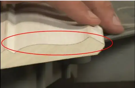

For an inside corner, don't concern yourself with mitering the moulding, instead cope the crown moulding. Basically what you do is cut one piece so it goes to the end of the wall. Cut the other piece at about a 38 degree angle and then cope the angled piece. It's a little hard to explain in text, but here's a picture and a link to the corresponding instructional video.
Coping moulding
As you can see by the red circled area, the author has emphasized the miter cut with a pencil. You would make a steep angle cut into the moulding along this pencil line following the contour of the moulding. After doing this, the coped piece should fit snugly against the flat piece and look like a nicely mitered joint.

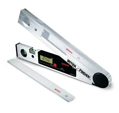

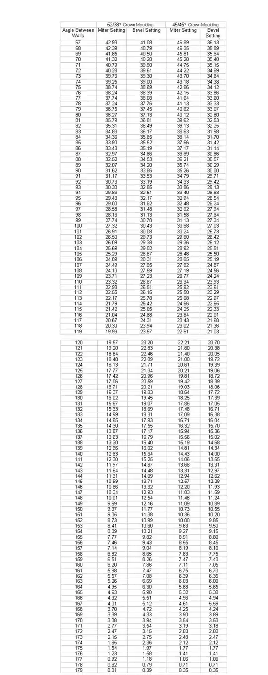

You could pick up a Bosch Miterfinder™ Digital Protractor
Features
  • Anglefinder — Determines the exact angles of jobsite or workpiece, eliminating guesswork.
  • Compound Cut Calculator — Automatically determines the exact miter and bevel settings necessary to make each crown molding cut fit precisely.
  • Protractor — precisely positions the workpiece or intended cut line at the desired angle
  • Level — Built-in vertical and horizontal spirit levels, accurate to 0 +/- 0.05°
  • Digital readout displays on front and back — For easier use
  • Hold Function - To freeze measurements
It will calculate the angles you need based on the actual angle of the corner, so you won't have to guess. You might not get a perfect fit every time, but you'll be very close so there will be less of an adjustment to make.
Miter-Bevel Settings Chart - Attached Below
