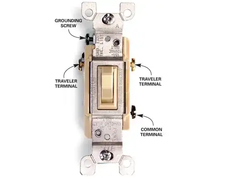

  6. Back at the box with the wire you identified as the panel hot, connect the hot wire to the "common" terminal of the 3-way switch for that box. Looking at the body of a three-way switch, the common terminal is the terminal that has another terminal screw on the switch body facing the same way, but doesn't have a screw directly across the switch body facing the other way. A picture's worth a thousand words; see below.

A three-way switch, with terminals identified
