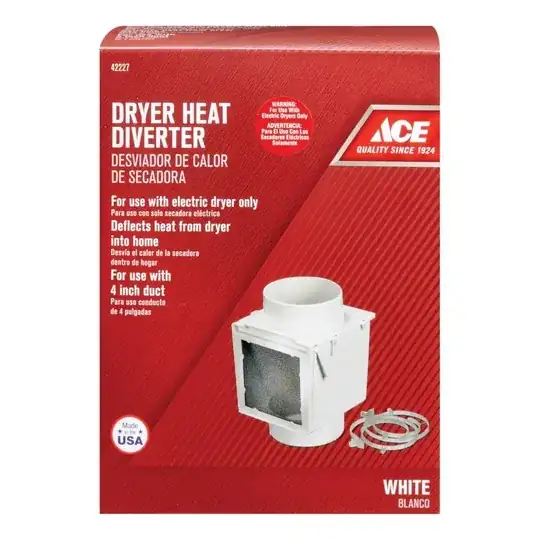

You can use a Dryer Heat Diverter: dryer heat diverter I've used one for 30 years; in the summer you vent the dryer to the outside, and in the winter you vent it to the space to be heated. For a large garage, the extra humidity in winter won't make a difference.
You get about 10k BTUs per run.
