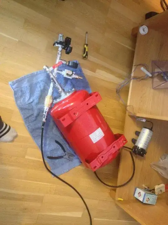

I've never built with pipes before so maybe I'd need some general advice regarding leakage. On a specific note, I've built a system (see picture) where it leaks practically everywhere. I've sealed it with NASTRO P.T.F.E tape on some places where it seems to work. I've screwed the pipe parts very hard so it shouldn't leak but it does.. a lot. It seems unreasonable that I need to use NASTRO tape everywhere. How do professionals do it? My bathrooom pipes doesn't have any tape, what are they doing differently?

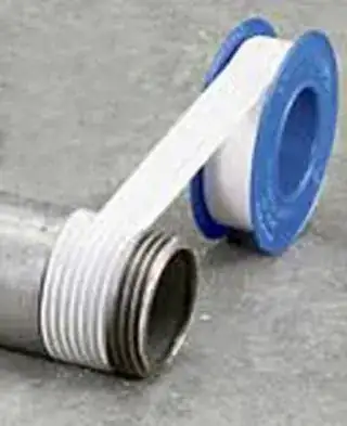

Hold the tape in your left hand – to avoid running it the wrong way and having it unravel as you start threading.
If you can bottom-out four adapters into each other, they're likely all the right thread type, you just didn't use enough tape. IME, warping it three times is sufficient. On fittings that don't like to cooperate, you may need substantially more to make the seal.
When applying the tape, you should only stretch it with enough pressure to let it sink into the threads. If you pull any harder, you'll cheat the depth of the wrap. Finish it by seating it well with your thumb or rolling it in your palm.

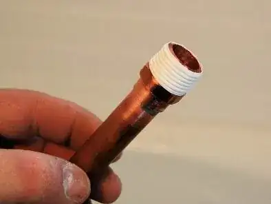

Imagine standing to the left of the photo. Hold the pipe in your right hand and the tape in your left, and it's basically impossible to do it the wrong way. It is recommended, as shown above, not to cover the first two threads but I do anyway. Having built up a good wrap at the rear threads, I'd finish it off with a warp or two around the starter threads, so that it looks like this:

Sorry for my original answer Lennart. I was thinking the red thing was an upside down compressed air tank & this was all pneumatics, though I did see your plumbing reference initially.
That's a lot of fittings & looking at it a 4th time, you look fine on matched fittings. However they do look thread bottomed, meaning you're out of threads for anymore tightening.
That would be the reason for leaks & you really shouldn't need tape much of anywhere. The "plumbing secret" is rubber type stuff. You need a lot of Washers &/or O-rings to make this work, at just hand-tight, without a single drip.
You'll have to get a box of "Assorted Washers &/or O-rings" at the store since none seem to have come with any of the fittings. Measure the receiving cup for sizes you'll be after. Washers for wide cup shoulders (if any) & O-rings for very narrow cup shoulders.
I don't know what you're doing & of course I know you don't know what you're doing, but the brass item & the 1 or 2 fittings on either side don't seem necessary. I thought it was a ball valve, but I can't make out a handle anywhere.
