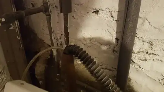

Any advice on unthreading old Brass pipe? The brass pipe is in the back with the spigot attached.
old Brass pipe

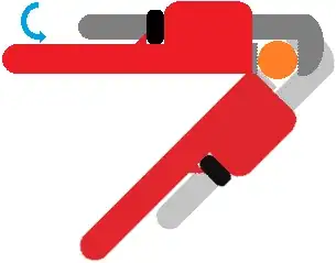

Two wrenches
If the pipe still doesn't budge, try putting a second pipe wrench in the opposite direction on the outlet of the tee. Then push the handles of the wrenches together.
  1. Put a second pipe wrench on the bottom of the tee outlet, with the jaws open up and the handle about 45° below the first wrench.
  2. Holding the second wrench stationary, push the first wrench handle towards the second.
Two Pipe Wrenches
The second wrench reduces the amount to torque transferred to the fitting, and gives you a bit of extra leverage.

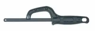

  2. Using a mini hacksaw, carefully make a few cuts into the interior of the pipe.
  3. Using a wrench, try to break the pipe nub up in to pieces.
Mini hacksaw
Be careful when making the cuts, as you don't want to cut into the threads of the fitting. Usually you can break or deform the pipe nub enough, so that it can be removed from the fitting.

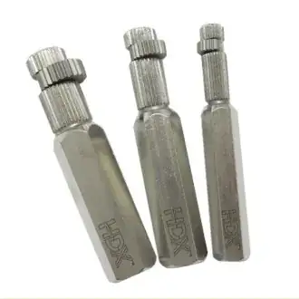

Lube it a bunch of times & let it soak for an hour between each lube. Then, heat it up with a torch or candle & go easy with a Pipe or Monkey Wrench. Hopefully it won't snap. But, if it does then you'll still be able to get that with an Internal Pipe Wrench bit.
IPW
