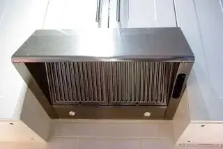

Hood above the stove
Here is the hood above the stove.

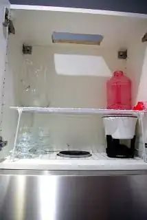

Opening above the hood
Here is the opening that empties into the cabinet above the hood.

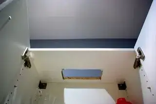

Hole cut in cabinet above the vent
The hood doesn't vent outside of the kitchen, just flows up into the cabinet and out the hole cut into the top into the room.

I would say that this is highly dangerous. It is against US and Canadian code to not have outside ventilation for any fuel-burning appliance in your home; that's your furnace, HWH and stove/oven, assuming all are NG or propane. It is only acceptable to have a "filter-only" vent hood for your stove if it's all-electric (which BTW is the case for every single apartment I've ever rented; gas appliances may be cheaper on utility bills in the US, but a gas stove is a huge fire hazard and general liability for any landlord).
The code is in place for a very good reason; not only can inefficient burning of fossil fuels produce carbon monoxide and smoke (both of which continue to cause damage long after you've reached fresh air), but even when these fuels burn ideally, they remove oxygen from the air and replace it with CO2. CO2 in itself is not toxic in the same way CO and soot smoke are; as soon as you reach fresh air the symptoms of CO2 asphyxia begin to dissipate, while soot and CO poisoning ("smoke inhalation") can kill you hours after you reach fresh air. However, the consumption of oxygen and production of CO2 in a space with inadequate ventilation is a double-whammy for anyone in the same space; the oxygen is being consumed so there's less of it even in upper strata of the room's air, and as the CO2 builds it settles downward in a "blanket", pushing oxygen up towards the ceiling and away from you.
As the CO2 level builds, your body's natural "inhale/exhale" reflexes go haywire in a Catch-22 condition called hypercapnia; your natural breathing while in a high-CO2 atmosphere actually increases the CO2 levels in your blood, but the only thing your body can do to reduce CO2 levels is breathe. So, you start hyperventilating, which only exacerbates the problem. Should you pass out from lack of oxygen, you will not wake up if someone else doesn't get you out of the room or get some ventilation of fresh air through it.
Your landlord is running illegal housing. However, he may not know it, so be nice at first. Follow standard procedure for maintenance requests, and ask the landlord to install a proper outside vent line for this fume hood. If he refuses or drags his feet, you can call in the city's Code Compliance officials, or federal HUD (Housing and Urban Development) representative, and they will MAKE the landlord comply. Depending on the terms of your contract, the landlord may be giving you a free out by not living up to his end, meaning you may be able to break the lease at no cost if this has gone on for some time with the landlord's knowledge and inaction.

There's two issues here. The first is the CO alarm. SOMETHING is wrong. It may be the stove, or some other combustion device in your house, but it's definitely something to pay attention to. I'd suggest getting a second CO detector and place it around the house and monitor the levels carefully. If it's the stove, it's less of a ventilation issue and more of a combustion issue with the stove...maybe it just needs a cleaning. Maybe you need a new stove.
The second issue is that hood vent. This is one of the more hilarious installs I've ever seen. Your landlord has an exhaust hood without it exhausting. It's just going into a closed cabinet. If you leave it as-is, that's OK, but it means you will have to take off the cabinet doors and remove everything from that cabinet so at least you get a circulating effect.
What is bizarre is that that appears to be a relatively high-end vent hood for an apartment. Why they invested money in that, but not properly installing it is a bit confusing.

Have a look at the 2006 International Residential Code. Here are a few sections that may apply.
Chapter 15 - Exhaust Systems
SECTION M1501 GENERAL
M1501.1 Outdoor discharge.
The air removed by every mechanical exhaust system shall be discharged to the outdoors. Air shall not be exhausted into an attic, soffit, ridge vent or crawl space.
Exception: Whole-house ventilation-type attic fans that discharge into the attic space of dwelling units having private attics shall be permitted.
SECTION M1503 RANGE HOODS
M1503.1 General.
Range hoods shall discharge to the outdoors through a single-wall duct. The duct serving the hood shall have a smooth interior surface, shall be air tight and shall be equipped with a backdraft damper. Ducts serving range hoods shall not terminate in an attic or crawl space or areas inside the building.
Exception: Where installed in accordance with the manufacturer’s installation instructions, and where mechanical or natural ventilation is otherwise provided, listed and labeled ductless range hoods shall not be required to discharge to the outdoors.
SECTION M1505 OVERHEAD EXHAUST HOODS
M1505.1 General.
Domestic open-top broiler units shall be provided with a metal exhaust hood, not less than 28 gage, with ¼ inch (6 mm) between the hood and the underside of combustible material or cabinets. A clearance of at least 24 inches (610 mm) shall be maintained between the cooking surface and the combustible material or cabinet. The hood shall be at least as wide as the broiler unit and shall extend over the entire unit. Such exhaust hood shall discharge to the outdoors and shall be equipped with a backdraft damper or other means to control infiltration/exfiltration when not in operation. Broiler units incorporating an integral exhaust system, and listed and labeled for use without an exhaust hood, need not be provided with an exhaust hood.
Make sure to check with your local government to determine what codes apply in your area.
