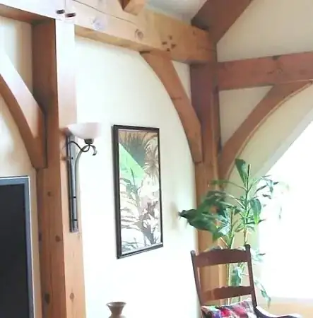

Edit- the picture below shows a similar (post and beam) style of building. The original building was a wood/furniture shop (not commercial); it was erected about 20 years ago (±5 years). The old exterior walls were removed (I don't know anything about them); the new walls are 2x4 construction with trim head screws, including the exterior walls. The friend is a maintenance guy... not an engineer.

The IRC does provide some pre-computed nailing patterns for wood-framed that Tester101 has quoted, but those only apply to light-framed platform or balloon-framed structures (see R301.1.2). It sounds like this structure is probably not that, since you have heavy timber columns. It could be post-and-beam or some other construction technique. In which case the structure needs to be designed by an engineer. (Or maybe the heavy timber is just decorative?)

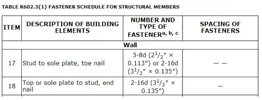

According to Table R602.3(1) of the International residential code (IRC), you have to use two 16d (3 1/2" x 0.135") fasteners to end nail the top or sole plate to a stud. If the studs were toe nailed to the sole plate, then either three 8d (2 1/2" x 0.133") or two 16d (3 1/2" x 0.135") fasteners would be required.
International Residential Code 2012
Chapter 6 Wall Construction
Section R602 Wood Wall Framing
R602.3 Design and construction. Exterior walls of wood-frame construction shall be designed and constructed in accordance with the provisions of this chapter and Figures R602.3(1) and R602.3(2) or in accordance with AF&PA’s NDS. Components of exterior walls shall be fastened in accordance with Tables R602.3(1) through R602.3(4)...
Table R602.3(1)
If by some chance these screws are equivalent to 16d nails, then they should be acceptable. However, I doubt they're equivalent, and therefore should not be used.
There's no specific fastener schedule for interior nonbearing walls, while interior load-bearing walls are required to be framed the same as exterior walls.
R602.4 Interior load-bearing walls. Interior load-bearing walls shall be constructed, framed and fireblocked as specified for exterior walls.
R602.5 Interior nonbearing walls. Interior nonbearing walls shall be permitted to be constructed with 2 inch by 3 inch (51 mm by 76 mm) studs spaced 24 inches (610 mm) on center or, when not part of a braced wall line, 2 inch by 4 inch (51 mm by 102 mm) flat studs spaced at 16 inches (406 mm) on center. Interior nonbearing walls shall be capped with at least a single top plate. Interior nonbearing walls shall be fireblocked in accordance with Section R602.8.

This line in the question and the picture says it all,
"The house uses 8x8s to carry the load; none of the 2x4 framing is load bearing"
This picture is a wood peg post frame building all the structural strength is there, if there was red vertical siding on the outside it would be called a barn.
Adding 2x4 framing between the outer side of the posts would just increase the strength and prevent racking of the posts, basically it would be built better than a brick sh*thouse.
While the heads on the screws aren't the best for the application the 2x4 walls would need to deal more with strain from the weight of the siding/stucco on the outside of the walls than holding up the building.
Basically it would have to rip a screw through the 2x4 sideways or snap them all from the weight of a 6' to 8' section of siding and drywall.
As long as he used enough screws to hold the walls up its just fine
