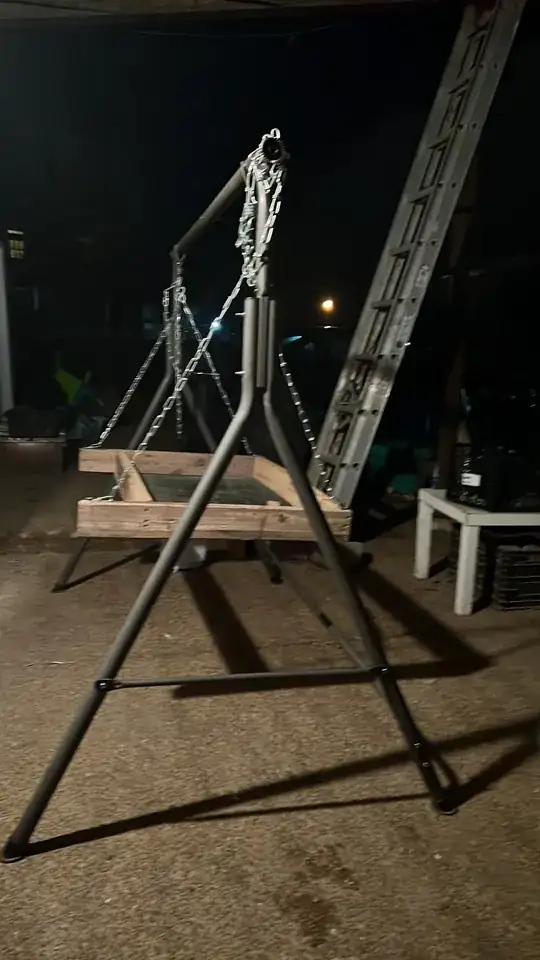

Welcome to my personal hell. I’ve been trying to clean this insane amount of muddy gravel from the original drainage area around my patio. I’m not even sure how I got here honestly.I noticed quite a bit in the dirt and then maybe I started digging and eventually hit the foundation footer gravel which I’m now having to keep from spilling out more than it has. It’s created a giant void and anyway I tried building a trommel that sits on casters but it spilled a bit too much out of the sides so now I found an old swing set on fb marketplace and hung my sieve from chains. enter image description here
