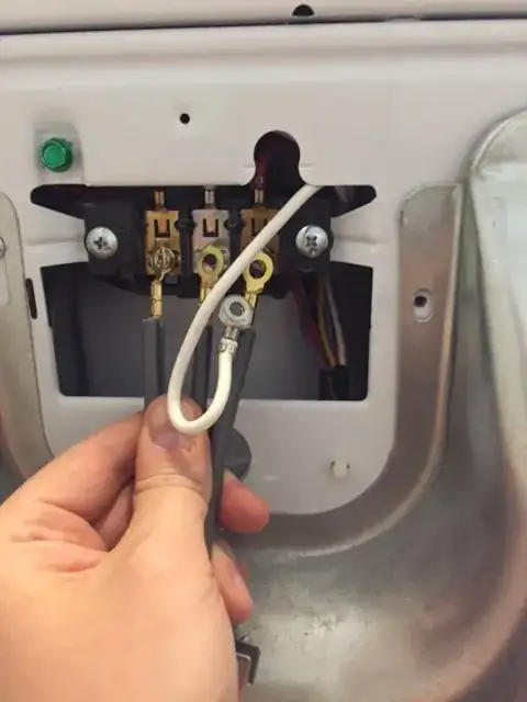

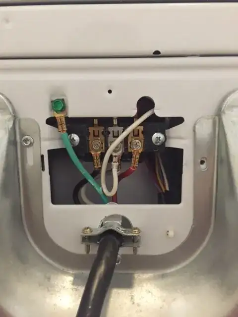

I recently moved into a home with a 3 prong outlet for my 4 prong Kenmore dryer. I went to Home Depot to replace the 4 prong plug with a 3 to match the outlet. I was ready to install the new plug when I noticed this white wire (2nd picture) and I'm not sure where it should be connected to. Originally on the 4 prong plug this white wire was connected to the middle screw (1st picture) but from the videos I've been able to see this seems to go to the ground (green screw). So my question is where should this white wire be connected to, the green screw or should I connect it once again to the middle bracket?
Original set up with 4 prong cord
Original 4-wire cord
New grey cord with White wire
New 3-wire cord

On a 4-wire cord , the middle screw is presumably where the neutral wire is connected.
On a 3 wire (and the whole reason 3 was replaced with 4) neutral and ground are the same. So white and green are connected, at least until you get around to running a 4-wire outlet. Normally detailed instructions are in the owners manual for your dryer - not infrequently they are also printed on the access plate for the wire connection, or a label nearby. If the "all gray" thing is your new cord, you probably need a jumper from the green screw to the center connection (and the white would go there as well.)
If you're going to a 3-wire cord (not recommended), you'll connect the white neutral/ground wire to the green ground screw.
The on the terminal block you'll have L1, neutral, and L2.

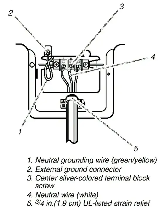

Here's a diagram from a random Kenmore electric dryer installation manual.
Kenmore dryer manufacturer's installation instructions 3-wire cord

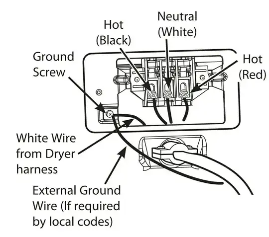

Here's another diagram from a random Kenmore electric dryer installation manual, this time showing a white bonding wire.
