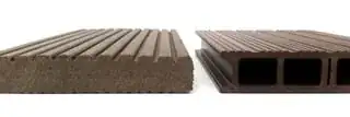

Solid Composite Decking (plastic)
(source)
I've no idea of its compressive strength, but I think it'd do just fine. It is expensive though.
