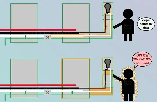

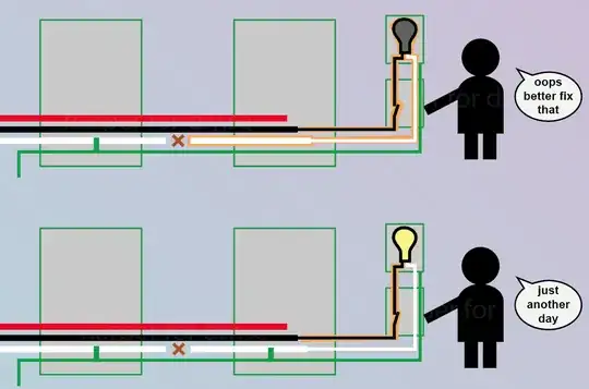

Let's try a few pairs of examples. The first is Code and the second bonds at the sub-panel also. The orange glow is on things which are "hot".
Seems awesome right? Poor old Code Man is in the dark. His power tried to return via neutral, and neutral is broke, so the power failed. Rogue Man is one happy guy and his life isn't disrupted. Ground is working great as a "backup neutral". He doesn't even know he has a problem!
Of course, ground is a thinner wire, so it might overheat, but so what? Or, what if both ground and neutral were cut?
Code Man is still in the dark and he's still gotta fix those wires. Rogue Man is dead.
In Code Man's installation, the hot went through the bulb, looking for neutral. It didn't find it, so it pulled the neutral up to 120V ( not enough power for useful work, but plenty to shock). It did the same for Rogue Man, but since he tied neutral to ground in the sub-panel, ground is now also 120V, including the service panel cover and the switch plate cover screws.
Suppose the sub-panel has its own ground rod. That doesn't help much. Earth tends to have high resistance, so the cover screws might be 103V instead of 120V.
