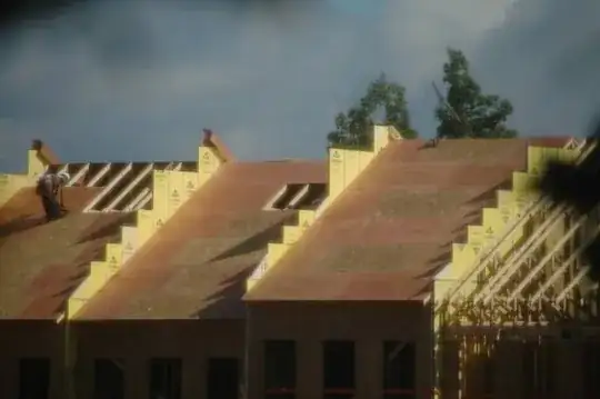

While watching the builders next door do their thing, I became curious with their technique to install plywood on edges neighboring the next townhouse, and OSB for the rest (which for these narrow interior units is a single panel in the middle, but they use OSB all the way to the non-attached side on the end units). What's the reason to pick one over another?
photo of the roof
Follow up: I'm guessing this is related to OSB's tendency to expand on the edges when wet, possibly for the flashing and the plywood side of the firewall that would rest on top of this edge of the roof. Here are some links that I came across when doing a bit of research:

They're required by 2012 IRC to use a fire retardant treated plywood on the roof within 4' of the UL assembly (the firewall that's between each unit). They can use OSB in the middle as it's much more cost effective than plywood.

The outer edges are fire treated plywood and have a reddish tint. Code requires a minimum of 4 feet from the fire wall. From seam to seam must be a minimum of 2 feet.
So to reduce waste the stagger from 4 feet to 8 feet (full sheet). Anything in between fire treated wood can be plywood or OSB.

Most likely the boards along the edge are a treated or coated sheathing product. Some common ones are "Blazeguard" or "Fireblock". In many areas earlier city codes called for gypsum board to be installed along the edges and these products provide the same fire blocking qualitites.
