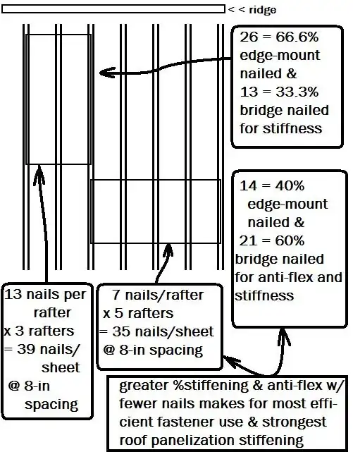

Nailing sheets longitudinally greatly increases the length(s), nails, and nail-downs allocated to edge nailing, the most problematic fastening that is required--you have one (eight-foot) line of rafter midline nailing for every two (eight-foot) lines of sheet and rafter edge nailing.
With transverse sheathing, the sheet length and nail count allocated to edge nailing is reduced by half and the rafter centerline nailing (and nail count) is increased by one third.
Additionally, longitudinal panel attachment leaves each panel spanning between two rafters and bolstered between by only one. By comparison, a transverse panel bridging two rafters, but only along half the length, and bolstered between by three rafters provides for a stronger, stiffer, more rigid overall system. It is that stiffness that, from the reliability standpoint, is instrumental in assuring least movement and flexing (with least consequent degradation) of the roofing materials, and of the roofing materials attachment.
Here is more to illustrate the above and the advantages conferred by horizontal and disadvantages otherwise. Note that "panelization" (the stiffening or a framework--namely of ridge, rafters, plate, etc--by spanning them with panels) has been given greater prominence. Ultimately, it is that aspect of panel fastening for stiffening that is at the heart of the OP question. Note also that horizontal makes more efficient (and cost effective) use of supplies: fewer nails to better effect; less cut waste of plywood or OSB. In statistical terms, it could be said that horizontal strikes a better balance between edge and spaced out fasteners; that it represent a more uniform attachment distribution...which optimizes a panel's panelization stiffening effect, and the mutual holding effectiveness of the nails.
