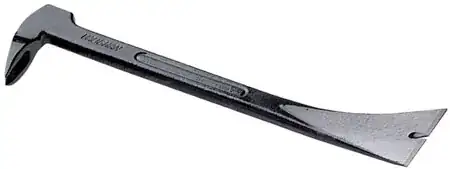

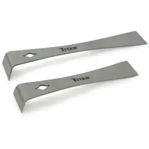

I like these:
They're about $10, and are very useful for finicky "demolition" work where you want to preserve the materials.

I have a quality steel Japanese made version of this style that is much thinner and sharper on the leverage end (right).
The thin cross-section allows it to slide behind just about any molding without damaging the edges while the width of the blade spreads the force so it doesn't readily split the wood.
