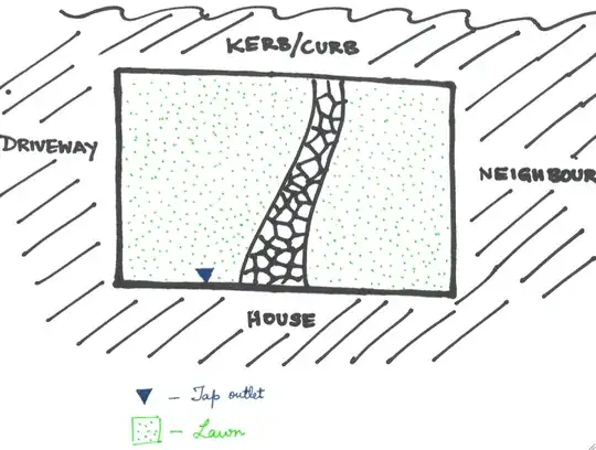

There are several great questions and helpful guides on and on this site. Since it's the lawn laying season now, I've started thinking about laying a sprinkler network prior to sodding because it's easier to do so now than after the lawn's established.
Here's a generic drawing of a front yard and the green dotted area is where I want the lawn to be. How do I go about planning a sprinkler network for my lawn and what factors should I keep in mind? I'd like to be such that no water (or as little as possible) falls on the kerb/curb or the driveway or into the neighbour's property.
In order to keep it general, I haven't listed any dimensions. Do not worry about calculating the exact locations or worry about the curves in the pathway. Also, do not worry about having to cut through the pathway to get the pipes to the other side. I'm looking for qualitative answers that explain how to approach the problem.

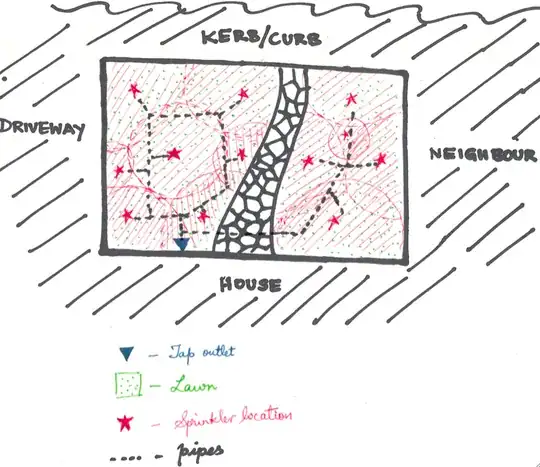

The answer I'm expecting is something that addresses these questions (see figure below) or any others I haven't thought of.
  • Do I need to use different kinds of sprinklers in the corners so that they're constrained to not cross into the kerb or the neighbour's yard? If so, can such sprinklers be adjusted to move between different angles as desired?
  • Should I choose a sprinkler with the biggest radius for the center? Can the radius be adjusted or is it fixed for a sprinkler?
  • If there are small patches that aren't covered by the sweep of any sprinkler, should I spend the money on getting another one to cover it or should I just water it manually? (see the small radius sprinklers in the left and the right parts)
  • How deep should I lay my pipes? Would it be helpful to have additional outlets at certain distances along the layout?
  • The most cost efficient way would be to lay the pipes along the shortest distance from a central point to each sprinkler (see right). However, if I want to have a flowerbed along the edges in the future which might need a drip system, should I plan for a layout like in the left?
  • Are there sprinklers that will let you tap out water optionally?

  1. Measure the area(s) you want to irrigate, then draw out a scaled drawing of the area(s). Add important information to the drawing eg

  11. A well designed system will overlap each sprinkler water zone by about 20%, this ensures good water coverage and minimises dry areas between the sprinkler water zones.
    • Also allows for things like windy days when the wind will effect the distribution of the water.

What you need to know in order to properly design and install an irrigation system for your landscape is more than can be covered in an answer on this site. (Though Mike Perry did a great job of covering the broad strokes.) The information would fill up an entire website. Luckily someone has created such a site. If you're serious about doing this yourself you must read Irrigation Tutorials.
Mike mentioned this site but I just wanted to add my endorsement for it. It is the most thorough collection of articles on the topic I have read and it is from an independent source who doesn't just pitch their own products.
Once you start reading it all the different factors and calculations may seem a bit overwhelming but as you continue to read and learn it makes more sense.
From the sketches you provided your sprinkler head placements would result in uneven watering. I made the same mistake when trying to plan an irrigation system before I started reading. Proper head placement and spacing is covered on Irrigation Tutorials.
