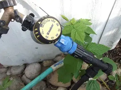

The basic main assembly would fit without modification. One of my assemblies even with Y-splitter is measured at 25 cm (10") vertically, and includes a timer, back-flow preventer, pressure regulator and a simple screen filter:
Basic main assembly
More elaborate set-up with a larger Y-filter, brass back-flow preventer, proportioner or other type of fertilizer injector may require more space indeed. Placing the whole assembly on the board to hang on the post or the wall and connect to it via short hose is a good idea, and it can be easily taken off as a whole for storage, but it can have its drawbacks, as it can be considered unsightly, and is exposed to the sun damage.

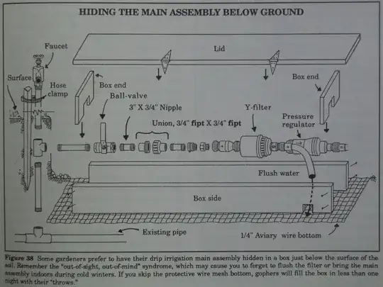

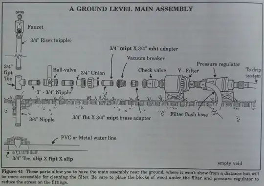

Another option is to place it at or below the ground level for concealment. Below are two illustrations from 1992 edition of Robert Kourik’s Drip Irrigation for Every Landscape and All Climates that show the main assembly set-ups below the ground in the box, and above the ground. For above the ground option author recommends letting the ground cover grow around it for protection and concealment (keep in mind the ability to remove it for winter storage — don’t let vines tangle it all up). Likewise, the box can be placed above the ground as well.
The illustrations present more professional assemblies cutting into water supply, and generally a little convoluted and complicated-looking (keep in mind, the book is also over 20 years old), but the basic principle applies for a simpler modern assembly, and the short length of hose from the bib can also be used to route into the box or to the ground level.

Lastly, important point to consider is that simple plastic atmospheric back-flow preventer may not work correctly if placed too low in relation to the rest of the system (some recommend 30 cm (12") above the highest point in the system), so you could screw it onto the bib itself before the length of hose, or use more expensive brass-type preventer and check-valve combination (check the local building codes for requirements — generally, check-valve alone is not enough) to place closer to the ground.
