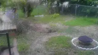

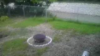

The majority of the grass in my backyard has turned brown and/or died after what we believe was a chinch bug onslaught that went untreated for way too long. It is St. Augustine grass in South Florida.
I finally treated the whole backyard with Spectracide, so hopefully that takes care of the bugs. Now the problem is repairing the damage. If at all possible, I'd like to avoid re-sodding due to the labor and costs involved, but if there's no alternative, then I'd at least like to make sure I do things properly to ensure the newly planted lawn thrives.
I have maybe 100-150 300-350 sq ft of surviving grass back there... is there any chance that the surviving grass will spread to fill the backyard (relatively quickly?) or that the brown/dead grass will regrow? Is there anything I can do to accelerate the process?
If not, is it time to just dig everything up and lay down new sod? What would be the proper way to do so in order to ensure I'll have a thriving, attractive looking lawn for my efforts?
Images below of what happened / what's left in case it helps (click to enlarge):
Backyard grass 1 Backyard grass 2

To keep things simple (mainly for my benefit), lets go with:
  • Total lawn area, 1500ft2
  • Healthy lawn area, 300ft2
  • Dead lawn area, 1200ft2
Therefore you have an area of 20% "healthy" lawn remaining.
Depending on what you read and from where it comes, it's "generally" said it is worth the time and effort to repair a lawn that has 50% to 66.6% healthy lawn area remaining, anything less than 50% is better served by removing everything and starting anew.
