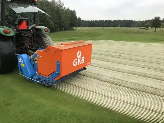

No. Depending where you live, sandy soil can benefit some grasses. Sand helps in lawns mainly to deter compaction; allocates better drainage. Silts/Clays are worse for lawns because they compact in few years and disallow water infiltration lower roots. Golf courses use it. enter image description here Sand cannot be compacted so is excellent filler. If you live in region with less than sandy soils, an addition mix of sand is a good filler for aeration and drainage.
